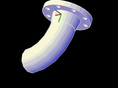

Hi,
When I change the UCS and want to rotate or move an object the GIZMO does not follow the UCS that I use, as you can see in the image:
Thank you.

I want to rotate the Elbow 45 degrees, I have changed the UCS but the GIZMO does not follow the user UCS, here is an other image:
I want to rotate on the Z axis.
I'm not a big fan of either Dynamic UCS or the GIZMO.
I'd relocate the origin of my UCS to the center of the end of the elbow where it connects to the weldneck making sure it was oriented correctly (I believe your UCS is good in that regards) then use the normal Rotate command.
Thank you ReMark , RO worked perfect :thumbsup:
You're entirely welcomed. Glad to hear my "old school" suggestion worked for you.

Right click on the Gizmo... Align Gizmo with > Current UCS
