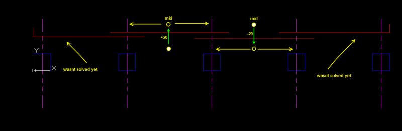

ok...one picture worth 1000 words...
in the attached image you can see what im trying to achieve , and hopefully my problem to set the mid point in different location each loop iteration.
this is the code i manage to write , in order to solve the problem , i've created a list (list '(+ -)) , and each loop iteration im trying to call that list with (car list) and than (reverse list) , so each iteration will trigger different function.

so...how to pass the + function as an argument to ((car opr) ang (/ pi 2))?
