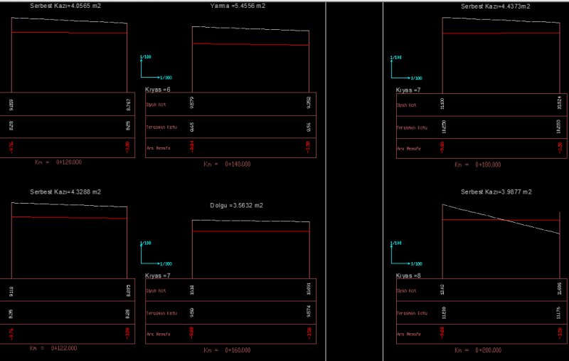

I want to macth the text objects in selection set and send them to excel as noted below. How can I match these texts? Do you have any suggestion?
...........A................B
1.....Km=0+120...4,0565 m2
2.....Km=0+122...4,3288 m2
3.....Km=0+140...5,4556 m2
4.....Km=0+160...3,5632 m2
5.....Km=0+180...4,4373 m2

Thanks BIGAL. I'm a little new to AutoCAD VBA. I didn't use SSGET before. I attach the .dwg file. I will be glad if you can do small example .
