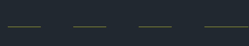

Found the first segment and the last segment not showing correctly (showing longer the others, supposed to be the same in length). Any solution? Thanks
AFAIK this is bug/feature of AutoCAD lines. The first/last segment will always be padded to to avoid starting/ending on a blank segment. Stetch with grips to see the effect in action. Be keen to see a solution to this.
It is displaying as it is meant to be. The first and last dashes always adjust themselves to suit.
That is also an old school hand drafting technique. I used to do it on purpose. We were also supposed to have the dashes and lines staggered in each of several close together and parallel hidden lines. Lengthening/shortening the end dashes accomplished that. AutoCad refuses to let me stagger the hidden lines, so close parallel hidden lines always look like rows of toothpicks instead of lines.
What would the solution be? I could see these three.
* You could strictly hold the dash (D) and gap (G) lengths and if the entity was longer than D+G*X (or some multiple of X), then there would be a gap in between the last dash and the ending GRIP.
* You could divide the entity length by D+G and then slightly adjust every D and G (not just the first and last ones) and have some sort of tolerance [(D+G length * 0.75) to (D+G length * 1.25)?]
* The current method of only adjusting the first and last D segment
