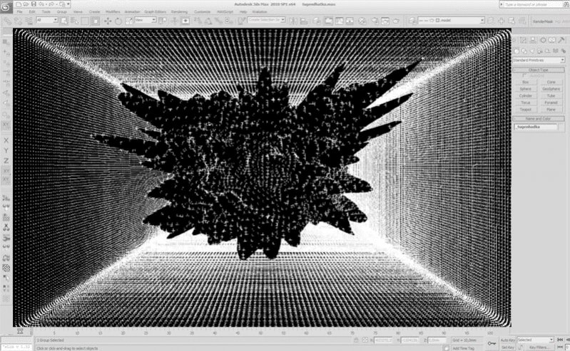

Hey, I need some help with this little project of mine, I want to create a short animation in some space pretty similar to this (excluding that boom effect or whatever it is): Bez názvu-1.jpg but I just cannot get to similar one, any ideas how to? Thanks a lot for any help. Sorry, if I am posting to wrong forum or anything.

Are you referring to the weave-like pattern on all four sides?
Yep, exactly.
I've done a weave using 3D solids in AutoCAD but I would not recommend it for what you are attempting to do. I'd consider creating the basic geometry (open ended cube) then applying a material and include a bump map.
This is the same recommendation that I would give. Since you're attempting to create an animation, you want to keep your poly count as low as possible. So just create the basic geometry and apply a texture map and a bump map or normal map. You could also use a displacement map, but that will increase your render times.
