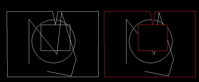

There is no problem to have one viewport over the other, but as you have probably seen, they two blend, they don't mask out one another. I think you can use a WIPEOUT to accomplish this, but I would use the VPCLIP command to clip the larger viewport to go around the smaller one.
Yes of course I could just draw the zoomed in viewport around the smaller zoomed out one...
That's good for now! I wish there would be a "masking" option for viewports though, would be pretty damn convenient, at least for me.
Thank you!
If the viewports are square then think about creating a viewport that is a keyhole but with the border on a non plottable layer using polygon option.
