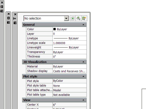

Ok see when you right click on the block and it has that bold "Insert Block..."? ... Ok hold right click and drag it and drop it to the work space area and you can see the option Insert Block or if you have the settings I have right now it only shows "Insert Here" rather than "Insert Block" ... I like the Insert Block better because when you click it, it gives you the "Insert" dialog box.

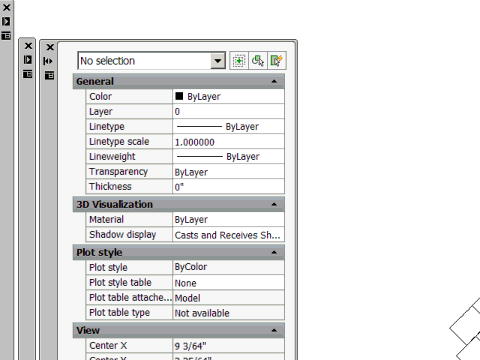

BTW, this is the behavior for 2011 through 2014, but perhaps 2010 may be different?

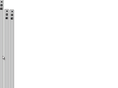

It might be blocked. Our PCs are limited to a lot of things. I insert dwg drawings as a block. The video you are showing last when you right click the Analog Integrated Circuits.dwg you can see the "Insert as Block..." option. You can right click hold and drag it to insert it and it would give me that same option. I can right click and it will show me the Insert as Block option but I want to be able to see it when I try to drag and drop. See if it works for you when you drag and drop the dwg.
