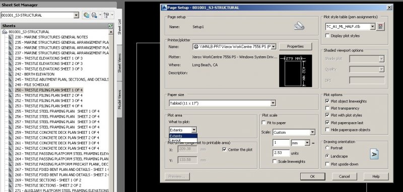

a_67vdub Posted June 24, 2014 Posted June 24, 2014 Well, I'm sure my "proof" isn't strong enough to hold up in court, but it's the best I could do. The attached screenshot is when managing pagesetups through the SSM. You can see that window isn't listed, just layout and extents. If I create a template with multiple page setups using various print methods, the ones with window don't show up when right-clicking some sheets, selecting publish, then publish using pagesetup override. I've experienced this behavior in Civil 3D and Autocad releases 2007, '10, '12, and now '14. If I'm doing something wrong, please let me know because I always liked window the best. But, either way it shouldn't be a deal breaker regarding SSM. If you have a lot of drawings per project, the benefits far outweigh the problems. Quote
RobDraw Posted June 24, 2014 Posted June 24, 2014 Yeah, your original statement was too broad. What you are showing means that you cannot create a page set-up utilizing window FROM SSM. That's got nothing to do with SSM ignoring page set-ups using window. Your original statement implied that sheets using a page set-up utilizing window would not show up in SSM. Quote
