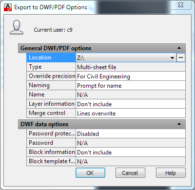

YZ Posted June 24, 2014 Posted June 24, 2014 Hi all, I recently had a laptop die on me that had a setting set to dynamically allow me to save a PDF to the same location the drawing was in. So when I plotted to PDF (using Acroplot PDF exchange), it always defaulted to the same location as the drawing so my PDF and drawings were always in the same folder. I once went in to change some options in the etransmit and the PDF export functions. Now they both stopped defaulting to be inside the same folder as the drawing I am exporting from. Other staff in my office still default to the corect folder, but mine defaults to the folder I was in during that experiment last year. I have never been able to restore the default because it only give you a folder option, which obviously cannot be dynamic. I have attached where I first changed the options ofr both commands, but now I cannot revert it to the OOTB default. This is one feature that I always wished for, and now they have it and I cannot restore it. I agree with OP, it saves time and also heaspace. Very beneficial. Maybe this will help you in your hunt for the solution? Quote

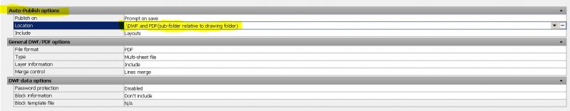

Dadgad Posted June 24, 2014 Posted June 24, 2014 Might it be as simple as setting your AUTO PUBLISH destination path, on the Plot & Publish tab in OPTIONS, as shown in the image? Quote

YZ Posted June 26, 2014 Posted June 26, 2014 Might it be as simple as setting your AUTO PUBLISH destination path, on the Plot & Publish tab in OPTIONS,as shown in the image? Thanks Dadgad. That option looks exactly correct, but it only enables Auto Publish when saving or closing a file. There must be a similar dialog box for when a user is deliberately publishing a PDF of the DWG. I still cannot find it. Quote
Dadgad Posted June 26, 2014 Posted June 26, 2014 I am way too busy to try this, but have you tried setting this destination location, and then going to and trying to etransmit, and see if it follows suit, it might. Then if it does, and you want to, you can turn off Auto Publish, once the location has been restored? Quote
YZ Posted June 27, 2014 Posted June 27, 2014 Dadgad, good comment. No I did not think to try this, but I like what you are thinking. I'll give it a go this morning and repost. Quote
YZ Posted June 27, 2014 Posted June 27, 2014 No luck, tried running the PDF and the etransmit command with the AutoPublish set to "relative", but it had no impact. Quote
