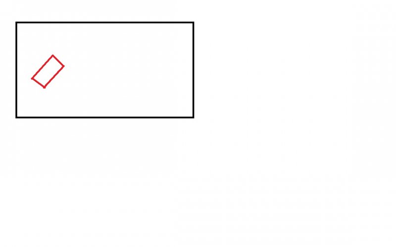

I am trying to plot a section of a drawing, but need the plotting window to rotate to best fit the area I am trying to plot.
Preferably in paperspace/viewport type of way.
I could rotate the entire drawing but I feel like there is a better way to do this.
Image attached. Black showing the rough area of the entire CAD drawing, red showing the approximate area I am trying to plot.

Exactly what I am trying to do. I was rotating the UCS but was not using the PLAN command.
All is well now.
Thanks nestly!!
