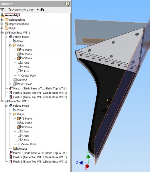

Hello everybody. I will try to upload an assembly file with a wind turbine blade in two parts. My problem is that I have constrained the top edge with a mate flush constraint and the connecting faces with a mate constraint, so far so good, I was able to position the top section by sliding it along. However I would like to lock it in its correct position. Is there any method or constraint that will remove the remaining degrees of freedom.

Mate Flush the corresponding part origin planes.
Looks like you will only need one of those Mate Flush (YZ Plane) constraints from your description.
Done it, Thanks again JD.
