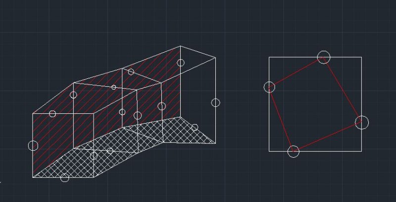

Hi, I need help about drawing in 3D but proplem is that i must draw polygons with points who does not represent corners, its in underground mine.
I drew simple 2D image to represent problem (in real life i have bunch of points wich are unevenly aranged), circles represent points by which i need to draw, one point represent roof, one for floor one for left wall and one for right wall, if I only drew by points I would get image on right red line but I need white line, its easy to draw cubes, rectangles and other things but this is mind-boggling for me.
I would apreciate any help or guidance, and sorry for bad english :oops:

I am not sure I fully understand the problem but how about the following?
Set ortho mode on.
Add a RAY through each point. The second point for each ray will be to the side or above/below depending on whether the point defines a wall, floor, or ceiling.
Use CHAMFER of zero at each of the 4points and you should have the desired rectangle which you can then convert to a poly line or region.
