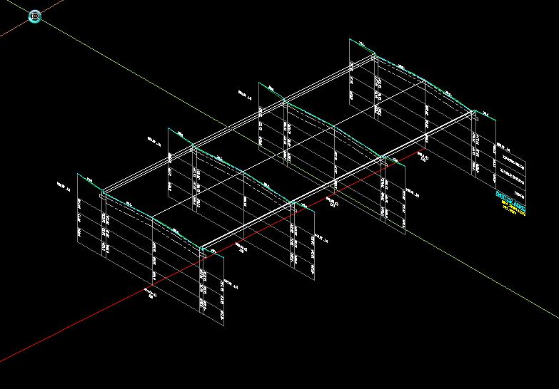

BIGAL Posted June 24, 2014 Author Posted June 24, 2014 Thanks Organic I guess what I was saying the way in which we view a design has not changed to much you have a Long sect and cross sect and a plan where is the pretty picture version like a holograph view. Look ar Revit And Architure how far they have come from flat 2d plans. Quote
Organic Posted June 25, 2014 Posted June 25, 2014 (edited) I agree. I don't think I've ever seen a series of cross sections presented in perspective view like in your screenshot either. The only time I view a 3d model is when checking a surface for accuracy. All construction documents we provide are still 2d cross sections/long sections/plans as you said. What we are doing a lot more of now is proving 3d machine control files for the contractors for their graders, diggers etc where they upload (or more often the contractors come to us and we upload it to their machine as they struggle with them) the design file direct to the machines inbuilt GPS and then grade/trench directly to those design levels using machine control. The inherent risk in this though is that all the guys on site then think they are surveyors and can set out everything themselves. I had a job today where the contractor thought the design was screwed (they were not using machine control on this job although setting everything out themselves with their laser levels); went out to the site and they had made a fundamental surveying 101 error (and I'm no surveyor although they were so wrong it was instantly noticeable)... the other risk is that if the design is wrong/not perfect, there is no where to hide when you are proving the design file directly for machine control setout and construction. edit: typo, should have been 2d, not 3d Edited June 29, 2014 by Organic Quote
BIGAL Posted June 26, 2014 Author Posted June 26, 2014 Re machine control I worked for Topcon its amazing had chance driving a grader the controls are a left-right arrow thats it, so you do not get lost. The movement of the blade was impressive going from -3% to +3% and watching it rotate with me doing nothing. But bottom line screw the model and grader will head for China. 2nd our 3rd party add on now drives cars at cross sections so can check bottoming out when turning in it would be nice if you took my 3d cross sections and one starts blinking hey you have scraped the Ferrari again. secret 3d cross sections "Rotate3d" Quote

Organic Posted June 28, 2014 Posted June 28, 2014 Re machine control I worked for Topcon its amazing had chance driving a grader the controls are a left-right arrow thats it, so you do not get lost. The movement of the blade was impressive going from -3% to +3% and watching it rotate with me doing nothing. But bottom line screw the model and grader will head for China. Yes, it certainly forces the designer to ensure the model is accurate and that the design works from the onset. 2nd our 3rd party add on now drives cars at cross sections so can check bottoming out when turning in it would be nice if you took my 3d cross sections and one starts blinking hey you have scraped the Ferrari again. I presume that is ARD. We've got a few guys here using it although I haven't seen that feature yet. Why do you need to check vertical clearance on a road design, should your vertical geometry/vc's not ensure clearance is not an issue longitudinally? Or are you fully modelling the driveways as well and checking vertical clearance when entering a driveway from the road? I've used AutoTrack (now Autodesk vehicle tracking or whatever Autodesk has renamed it too) before to check vertical clearance (along a 3d polyline) when going from positive road crossfall to steep negative grade driveways etc although found it a bit of a hassle. I prefer to just manually check using paper & pen and the paper based clearance templates. secret 3d cross sections "Rotate3d" Thanks, I'll check it out some time. Quote
BIGAL Posted June 28, 2014 Author Posted June 28, 2014 Re Scraping We have to check the vehicle entry into a property from the road and make sure they dont touch. We have a dirt road and are now constructing it over time the car scrapes away the dirt till it just misses but is not a acceptable shape longitudinally when being rebuilt and having kerbing. Organic In ARD its part of the cross section viewer to see a vehicle and it moves across the profile. You can customise the vehicle shape also. The check is good in that it is normally at 90 deg so its the most extreme check as a car normally enters with a slight angle. A side note 2 comments I wrote a vehicle check a few years ago copies a car along a pline. 2nd worked within a company with the principle of ARD for many years. The rotated cross sections maybe usefull for some form of presentation. Quote
