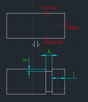

1. Enter A value
2. Enter B value
3. Select the first line
4. Select the second line
5. Select the endline
The result like this
I think can use lisp to do this ,Thanks for help!

Thank you very much ! jdiala .
Your routine is good , There is an alternative,as follow
There is a "L" value,
BTW. when choose lines, the first line and second line must can't be the same line.two lines must be parallel. Otherwise, prompt it.
Thanks again. jdiala.
Per your second request. Try this.
Big thanks ,jdiala, The routine is very perfect. :D
All the best
andy
