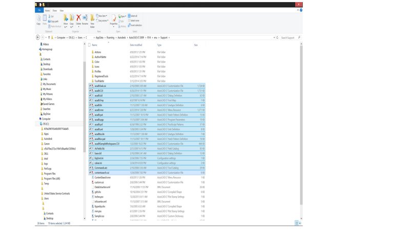

LT does not have modifiable "USER" profiles, but it does have a single default profile. The customization files such as saved workspaces, tool bars, line types, hatches, and anything like that, that can be customized is considered part of the "profile". These files are located in the enu folder of the support path. Did you recently move to another computer?
It could be one or more of the following files that needs to be located or replaced with a backup. You'll have to save as... the png to read it. That's as big as I can make it.
