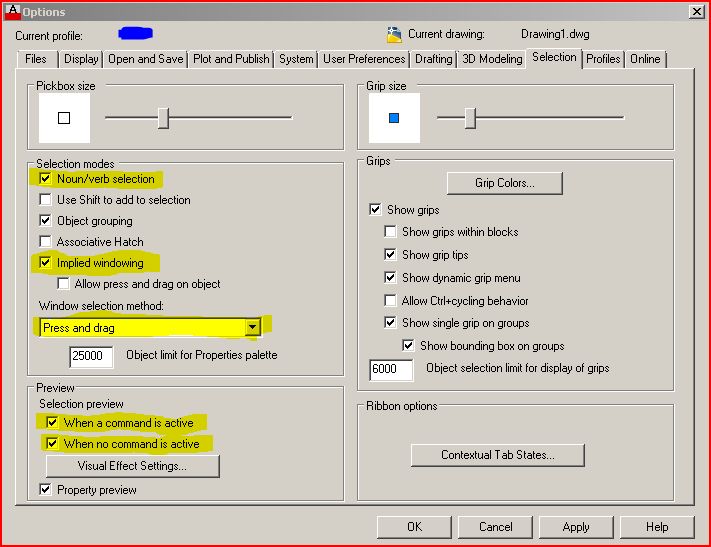

I do not know why but the strech and move selection windows are missing.
Also when i move oe strech the objects do not move until i slect the second point.
It sounds like you need to open OPTIONS and pay the SELECTION tab a visit.
If these values seem to have inexplicably changed, it may well be related
to the use of a new, and poorly written lisp.

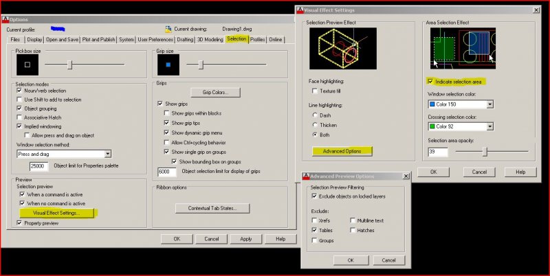

I have confirmed that the selection tab settings match the jpg you posted but the issue remains.
There is no selection window for strech and when i move objects they do not follow the curser.
In that case, you may need to dig a bit deeper. :huh:

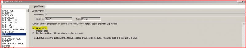

Then again, maybe he has turned off your grips, as shown in the screenshot from SYSVDLG. If so I would suggest restoring it to the OOTB setting of 2.

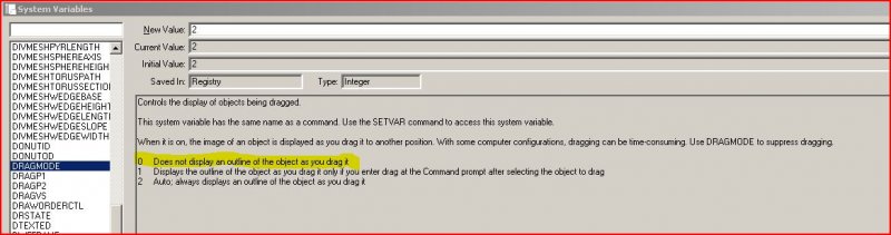

Set DRAGMODE to auto ?
Nice one rkent, that could be it! :beer:
Thank you everyone dragmode fixed it. I set the dragmode to 2.
