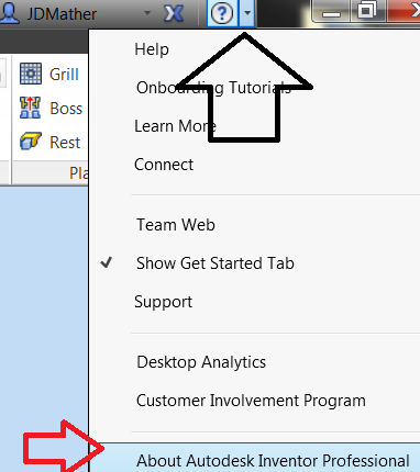

Click here and here and erase all doubt.
