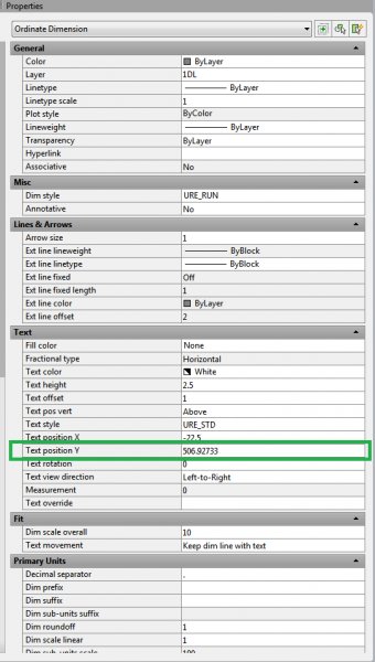

Hey guys,
Just wondering if someone can please help me get the following code working?
(DEFUN C:fRD ()
(prompt "\n Select DIMENSIONS to fix offset...")
(Setq ss (ssget '((0 . "DIMENSION") (-4 . "<OR") (70 . 38) (70 . 102) (70 . 166) (-4 . "OR>"))))
(setq gpt1 (getpoint))
 (setq num (sslength ss));n° object
 (setq con 0)
 (repeat num
 (setq ent3A (ssname ss con))
 (setq con (1+ con))
(setq vObje (vlax-ename->vla-object ent3a))
             (vlax-put-property vObje '[color="red"][b]TEXTPOSITIONY[/b][/color] (CADR GPT1))
The aim is to be able to select a bunch of ordinate dims, and then pick a point and the Y value of this new point will be assigned to the "Text Position Y" of the ordinate dimensions selected... I hope that makes sense.
The problem I am having is I do not know the correct variable name for TEXTPOSITIONY, so I was wondering if someone could please enlighten me? Or if someone knows of a resource where all the Active X variables are listed - that would also be great.
Thanks a lot for any help, looking forward to hearing back.
Replace this part .
(vlax-put-property vObje 'TEXTPOSITION (vlax-3d-point (list (car (cdr (assoc 14 (entget ent3A)))) (cadr gpt1))))

Hi again Tharwat,
After a bit more testing, I have got the code working exactly how I wanted it - so thanks again for your help.
(DEFUN C:fRD ( / ss gpt1 num con ent3A vObje )

A change I made was to use ASSOC with DXF Code 11 - as this seemed to produce better results regarding the base points of the text. Does that sound right to you?
Using the dump option on an object oftens reveals the variable name you were after, often a slight difference from what is displayed in properties.

Hi again Tharwat,
You're welcome .
Yes , to confirm between my approach and yours , have a look HERE.
