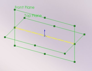

I am hoping that a Guru here will have the time to give me a step by step procedure for tilting one of the default planes to an angle that I can specify. As you can see I am really new to solidworks.
I have enclosed a screen shot of what I am looking for.
Thank you in advance,
chubarka
The origin planes are datum - cannot be changed.
Create an axis at the intersection and use the axis and one of the planes to create an angled plane.
