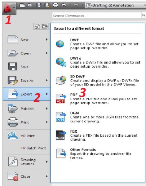

I usually use Export /pdf and either pick current layout or all layout
if you have set your layouts correctly in page setup manager, it works a treat
give it a go
Export to PDF is the same thing as plotting using Dwg to PDF. The interface is a bit different but the options are all the same. The only reason you would get a different result from "Export" is because the settings are different.
