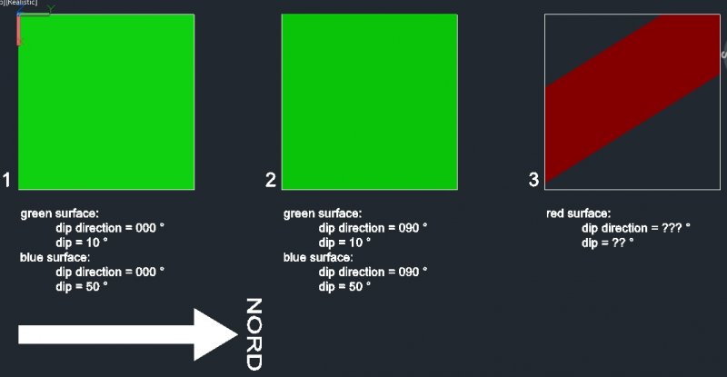

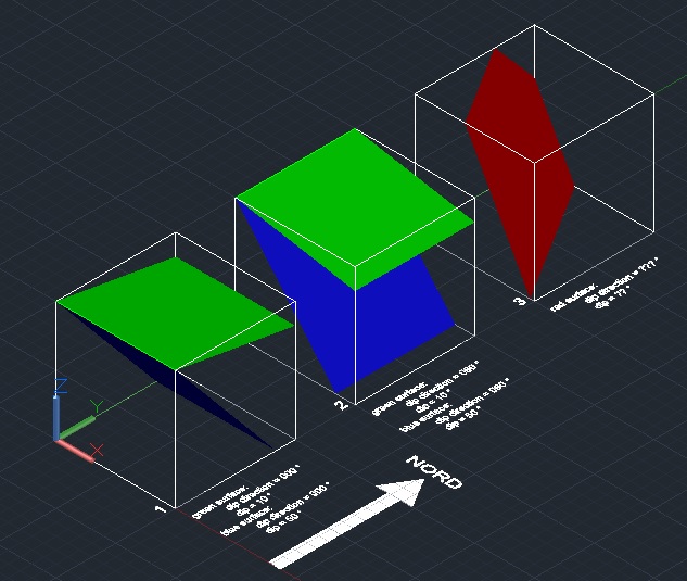

following this graphical representation:
I was wondering if there is a method in autocad to know the orientation of the red surface inside the 3rd cube (cube nr. 1 and 2 are examples). The orientation is dip direction and dip of the surface the considering the Y axis as the Nord (see images below).
Here is also the dwg file:
cadtu.dwg
ps: sorry for my English
One way would be to draw a line normal to that face. Set a UCS aligned to the face, then create a line from 0,0,0 to 0,0,100.
That line can then be dimension via its angular displacement from the two pertinent directions.
cadtu_withNormal.dwg
