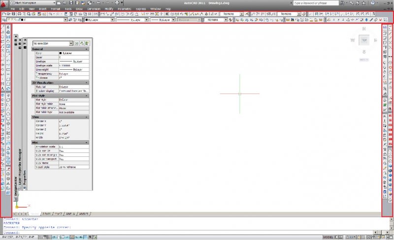

nestly Posted July 21, 2014 Posted July 21, 2014 damn. I think it is 2004. Does that mean all of every tool (line, arc, dims, fillet, chamfer, trim, etc) have to take up all that room at the top. Im just so use to hovering over the drop down and picking what to see when i want to see them. I still recognize them as far as now but it is a little frustrating. I dont think the program works works as proficient either. Yes, 2004 definitely only has toolbars (and menus) as a graphical interface, but I believe your perception is skewed about how much "room" toolbars occupy. The screenshot below shows two rows of toolbars across the top, two columns on the left and two columns on the right, and those 200+ tool buttons actually take up less screen real estate on 1920x1080 or better display than the Ribbon which displays only about 25% as many tools at any one time. With regards to proficiency, that's a matter of choice/preference. I guarantee I can pick tools from on-screen toolbars faster than anyone can change Ribbon tabs and pick tools from panels. Quote

nestly Posted July 22, 2014 Posted July 22, 2014 Yes, customizing the Ribbon certainly makes it more efficient, (just as customizing toolbars and menus make them more efficient) but it can never be more efficient at displaying tools than toobars even if all the large icons, text and flyouts are removed because at best, it simply becomes one large "toolbar". I'm not saying the Ribbon is all bad, in fact I quite like the contextual tabs, I was just making the point that it generally uses more screen space than toolbars and will almost certainly require more clicks and mouse movement to access the same number of tools. Quote
