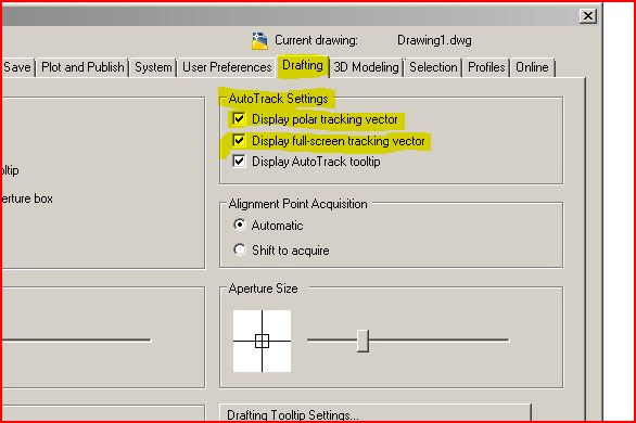

Dadgad Posted August 1, 2014 Posted August 1, 2014 I have never used LT, do you have the Dynamic Input option available? Have you tried using the Extension O snap? Have you tried using full length crosshairs on your display? What are your auto tracking settings, if they exist on the Drafting tab, as shown in the snip. I too started on 2009, with the Dashboard! Quote

bjenk8100 Posted August 1, 2014 Author Posted August 1, 2014 ill double check tomorrow. almost positive there is no object tracking in lite. it has tracking after you start to draw but you cannot drag off something that tracks off of that to start at an exact level. I use a large crosshair but using that to line up to something away from where you are is not exact. Then applying dimensions would not be exact which is maybe one of the first things i learned, draw everything to scale or it will eat you alive later. Quote
