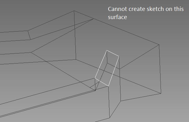

Hello,

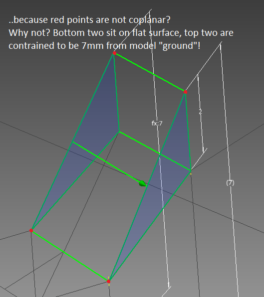

I have a loft with two profiles which defines a ridge feature. The top surface of the loft (on Front view) needs geometry to be defined to continue it, but Inventor does not allow a sketch to be created on that surface. Presumably because the 4 points are not coplanar - but I can't understand how that can be:
* Loft is made of two triangles
* The "top" vertex of both triangles is defined the same lengths from model "ground", in direction perpendicular with model axis
* The "bottom" vertex of both triangles lies on a flat surface perpendicular to model "ground".
* Triangle bases are coplanar with model ground
* This means a surface containing two top points of both triangles and two bottom points of both triangles as its 4 vertices is a plane...?

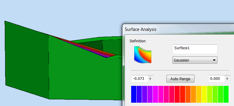

I might see geometry a little differently - but it is obvious to me that face isn't planar without even doing any inspection.
But go to Inspect>Surface, click Autorange and Apply.
or
any plane can be defined by 3 points.
Start the workplane and pick any 3 of those 4 points - you cannot create a plane that will go through all 4 points.

And yes, an easy way to check to see if a face or surface is planar is to simply try to select it for a 2D sketch. Inventor will only allow selection of planar geometry for 2D sketching.

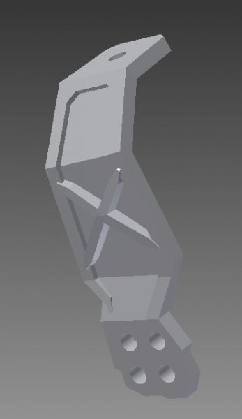

I re-created the features using "surface extrusion and plane" approach; defining the top profile on one plane, extruding as surface, and then slicing off the top with another plane. This has the advantage of the top surface being a guaranteed plane, simpler process, easier to modify, and it seems like more intelligence is built into the model.
For anyone who might be interested, I am attaching the completed model (excluding the diamond tread cross geometry, which runs file size over limit, but it's done the same way).
UpperArmShoulderSmall.zip
