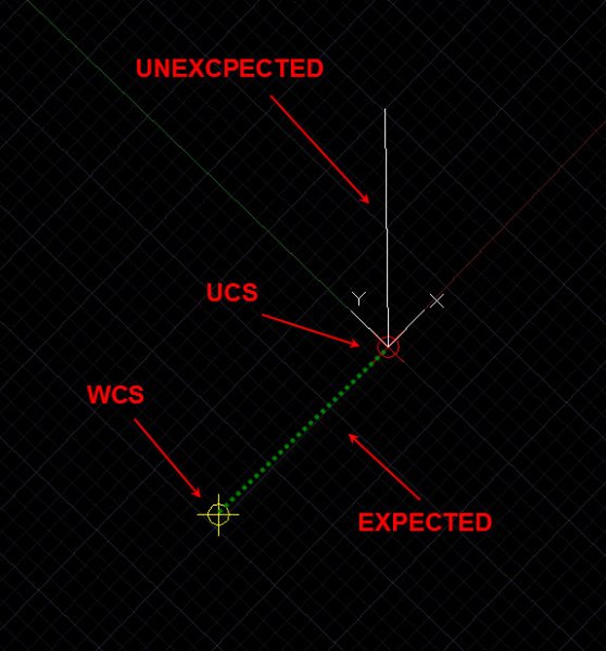

Hi
I've opened a case study in order to investigate the subject of coordinate system. would like to get get challenges from the gurus here(basic to advance).
my first basic challenge is to adopt a new ucs, and draw a line between the WCS origin to UCS origin.
in my code i translate the UCS 0,0,0 coordinate to the WCS but its draw a line which is not as expected.why?
help please!
;draw a line from Ucs origin to the WCS origin
(defun cs1(/ WCS UCS)
 ;get WCS  orign
 (setq WCS (trans '(0.0 0.0 0.0)1 0))
 ;get UCS origin
 (setq UCS '(0.0 0.0 0.0))
 ;draw line
 (command "_.line" "_non" WCS UCS "")
Thanks
Shay
Hi
if WCS=UCS, zero line created. unless USC moved or rotated then can see the difference.
But i test it where ucs unequal wcs
i don't really understand "draw a line which is not as expected" :)
nothing drawn?
can you show image?
nothing drawn?
can you show image?
Hi
the lines is drawen , but not where i ment
look the visual
Commands use UCS points - you are translating the UCS origin to WCS; use (trans '(0.0 0.0 0.0) 0 1)

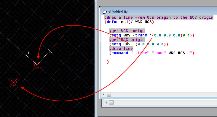

Hi Lee
i just figure it out
its like to say:
"translate (0.0 0.0 0.0) from WCS to current UCS"
(trans '(0.0 0.0 0.0)0 1)
