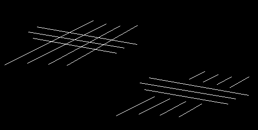

rkmcswain Posted January 23, 2009 Posted January 23, 2009 what do you mean by wipeouts? A wipeout is an AutoCAD entity type. It's used to "wipe out" areas of a drawing by hiding geometry behind it in the "Z" order. Other geometry can be on top of the wipeout. The image on the left has no wipeout, the image on the right uses a wipeout. The lines appear broken but they are not. Quote
