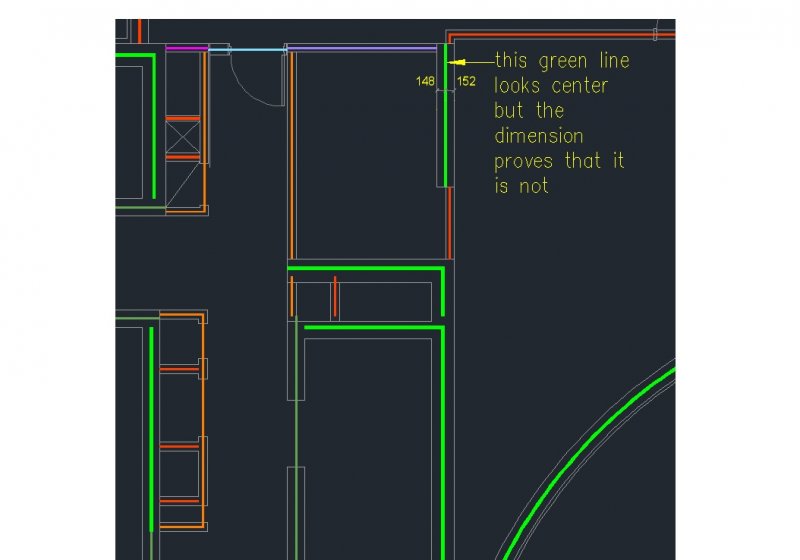

vernonlee Posted August 8, 2014 Author Posted August 8, 2014 Above part of the dwg i am working on. The grey colour is the walls. The coloured lines in the center represent different wall materials. As can be seen some are not centre as the layout as been amended. This are the obvious ones. But some although looks center, has too be measured to verified it. See my comments. I have dimension it for easy understanding. This is like about 10% of part of a single drawing. I have total about 30 such drawings. hope you guys understand why i am asking for help. Thanks Quote
pBe Posted August 8, 2014 Posted August 8, 2014 So are you asking for a program that will "fix" the walls for you? or just a routine that will tell [or show] you that its not equal? Quote
vernonlee Posted August 8, 2014 Author Posted August 8, 2014 So are you asking for a program that will "fix" the walls for you? or just a routine that will tell [or show] you that its not equal? Just a way to highlight those lines that are not equal/ center between the walls. Quote
pBe Posted August 8, 2014 Posted August 8, 2014 Okay, in that case we need a sample drawing as a go-by otherwise we would be guessing what or what not to consider. Quote
vernonlee Posted August 22, 2014 Author Posted August 22, 2014 Okay, in that case we need a sample drawing as a go-by otherwise we would be guessing what or what not to consider. Attached is a small sample of the plan. The wall line is in layer 0. The center wall is under different wall types layer. This are the lines that need to be check if ther are center of the wall or not. Hope to have a script or lisp to help witht eh process instead od manually dimensioning 1 by 1. wall with center line.dwg Hope to get some help on this. Thanks Quote
