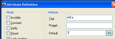

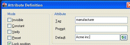

steven-g Posted August 5, 2014 Posted August 5, 2014 Do you have blocks that contain attributes already? if so then you need to create a text file so that Autocad knows what you want to extract, use windows notepad, it is nothing special just a simple text file. You need to enter the TAGS from the attributes you want to use and then tell Autocad whether the value is text or numerical and how long it likely will be, for example an attribute that has the tag ArEa You would enter AREA N003002 the text is not case sensitive and it's normal to use uppercase, this is followed by a space then either the letters "C" to show the value will be a character or "N" if it will be numerical, the 6 numbers following tell Autocad how much information is going to be in the value, the first 3 is just a straight count so "003" tells Autocad the value will be a 3 letter word or number up to 999, you don't need to be exact I usually use "030" unless I know it will be a long text string. The second 3 numbers are only used for numbers to show how many decimal places should be included so "003002" would give anything up to 999.99. If the value is text the last 3 should be zero "003000". The next attribute is just text so notepad now looks like this AREA N003002 MANUFACTURER C030000 add as many tags as you like, you can also get information from the block like it's name or position (take a look at the help files for how to get that) for example will export the blocks name. BL:NAME C030000 The text file can contain tag names from various blocks they don't all have to be in every block, when Autocad is collecting the details if there is no tag that matches the name in the text file it will just ignore it (so if you spell it wrong it won't be extracted). PS All your tags should have unique names, although you can have 2 attributes in a block with the same name Autocad will only read one of them. Having the same tag name in different blocks is OK but it is logical that they should contain similar values. Make sure you press enter after the last line in the text file and then save the file, this is now your Attribute Extraction Template, put it in a folder so you can tell the ATTEXT command where to find it. That's it. Run ATTEXT and the dialogue will ask you to select the objects to Extract attributes from (either pick the blocks or just type "all" and press enter) click on the template file button and tell Autocad where the text file is, and then click on the output file button an tell Autocad where you want it to extract the data too (again this is just a plain text file so type a name). You need to select how you want the data stored so choose 'CDF' ,'SDF' or 'DXX', for excel CDF is fine. Click ok and Autocad should tell you it has output 'XX'-records in extract file. Quote

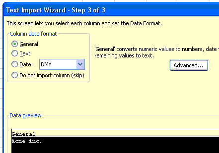

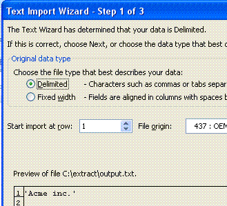

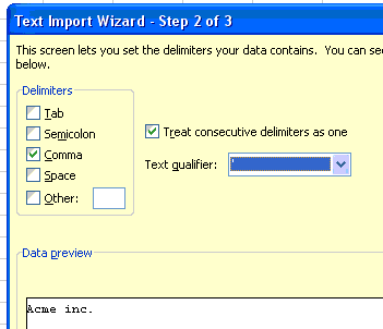

steven-g Posted August 5, 2014 Posted August 5, 2014 Open excel goto the data tab and select get external data from text file, where it is depends on which version you have, this opens a dialogue box with 3 steps step 1 select delimited data step 2 change the delimeters to 'comma' tick the box 'treat consecutive delimeters as one'. change the text qualifier to a single quote (I have to - there is a preview box at the bottom and it should show what is in the text file, when you pick the correct value the symbols disapear in the preview - try it you'll see) step 3 I've never changed anything here, except clicking on the Advanced button (just because in Belgium they use a comma as a decimal point) so click finish and excel will ask you if you want to import the data into the current sheet starting at the active cell (usually A1) Your situation maybe different but hopefully this will get you started. Quote
