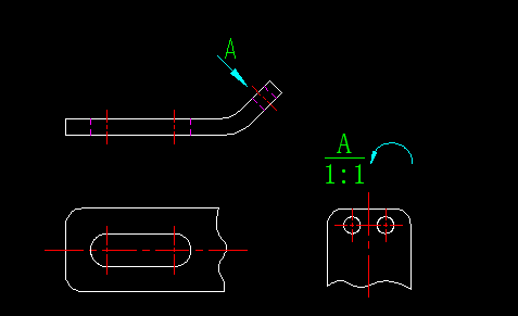

Hi all
Have a routine like this?
use dialog to choose
[ATTACH]50258[/ATTACH]

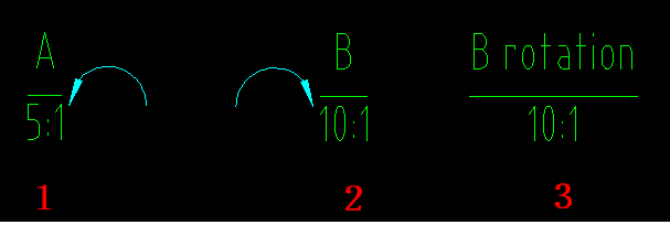

symbol: A,B,C,D......Z
scale: 1:1.5 ,1:2 ,1:2.5 ,1:3 ,1:4 ,1:5 ,1:10 and 2:1 , 2.5:1 , 4:1 , 5:1 ,10:1
Dir.of rotation: left rotation , right rotation , and rotation
example
1. symbol "A" , scale"5:1" , "left rotation"
2. symbol "B" , scale "10:1" ,"right rotation"
3. symbol "B" , scale "10:1" , "rotation"
The height of rotating symbol (with arrow)= The text height
Thanks Alberto

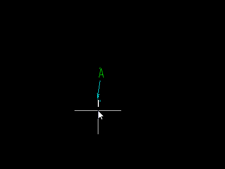

Hi I didn't say clear ?
1st, draw arrow lines, specify the direction .
2nd, Place the words and symbols shown in figure 3
hi rrulep, what is related the 1st gif arrow & the last img?
by dim qleader can't do?
step 1: you should help yourself by making an attributed block, then get it saved try insert into dwg
step 2: test function

hanhphuc, thanks for reply.
why use attributed block ? I think lisp can do this.
Hi hanhphuc.
This is a complete example.
In order to make the looks beautiful, I think :
Arrowed line length=text height*2 , Size of the arrow=text height
arc radius(with arrow)=text height , Size of the arrow=text height / 2
Hope someone can help me.
1. lisp can do many things, using command TEXT also can do easily, which "symbol" over "%%o" "scale"
2. my suggestion making 2 attributed blocks with arc arrow mirror (name it "CW.dwg" for clock-wise & "ACW.dwg" for anti-clockwise),
the reason attrib block you can D.I.Y (customize it to suit your need) without lisp code :)
use command INSERT & Qleader method, no need complicated coding.
i have finished my part in vanilla coding, without using my old post func: (eat$ e l)
have you made your attributed blocks as i proposed? clockwise: "CW.dwg" & anti-clockwise: "ACW.dwg"
put it in valid support path.
Latest Updated v1.2: 31/08/2014
>added dynamic visual arrow
>Draw ARC function to replace INSERT if no attrib block exists in support path or broken path

1.draw arc using command: ARC
2.draw arrow command: DIMARC
explode it then remove one side arrow
3.make 2 attrib Tag, align nicely
4.save drawing as CW.dwg or ACW.dwg
5.put in valid support folder
Then load the lisp, run.
As you can see Lee Mac's codes drawing arc already has such long code, i still light years to achieve his level :)
That's why my concept is simple just by INSERTing attrib block
My code still has bugs, but I'll fix it soon.
