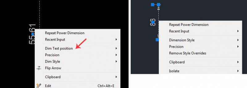

hi,
autodesk eliminated the option " dim text position " to edit Dimension in autocad mechanical 2014 ? :?
any way to fix this?
sorry my english isn't my native language
thanks.
Instead of right clicking, hover over the grip on the dim text and a set of options will appear. Hope that helps.
thanks, but are different options.
What options are given in the older release?
