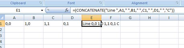

BIGAL Posted August 9, 2014 Posted August 9, 2014 1st up I am not electrical savvy What their talking about is using excel to create a script of commands and draw objects. The example below is to draw a line. To make any real comment need two things Autocad Dwg and excel, image or files that clearly shows the links between the two You are right I know something I did about 20mins manually now 3 seconds. Quote

steven-g Posted August 12, 2014 Posted August 12, 2014 I have been told that you can create a drawing in about 10 seconds that would normally take 4-5 hours. Did they also tell you that it could take a week to write the script, it depends on what you are using it for, I use Excel to to produce scripts for drawing cabinets, it even outputs to a ???.scr file, but it's better just to copy the results and paste directly onto the Autocad command line, the cabinet size is driven with just 3 values height width and depth. BUT it will only draw the same design, if you need a small design change it could take hours to make the changes in Excel as opposed to minutes in Autocad. For standard items that may just need a few variables changing it's great (but dynamic blocks maybe better). I have to add it's nice to see a drawing appear before your eyes at the click of a button Quote
