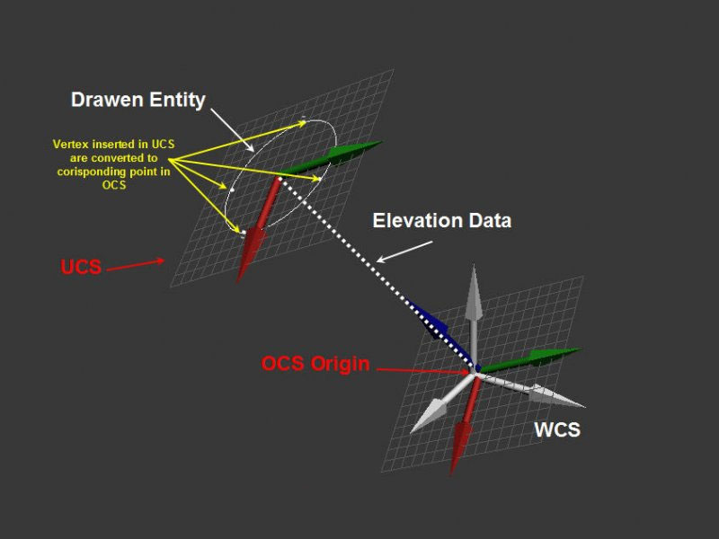

i visulze that proccess like that :
User adopt new UCS and draw a circle, than the circle points were translated to OCS using the elevation and Z vectror.
am i right?
Thanks
Shay
You permuted UCS with OCS... UCS is active plane in witch you draw entities (arrows in the center of circle may approximately correct correspond to UCS, but it may not be exact true; UCS is system witch is coplanar with drawn one in center of circle, so when in UCS you can draw circle in that plane - you can draw circle with circle command)... OCS on the other hand is system witch is parallel to drawn object in 3D space, but its origin doesn't match origin of corresponding object in 3D space - its origin is WCS 0,0,0 point... But remember OCS is parallel to drawn object in 3D space... So to me it looks that you almost post correct picture, only you presented OCS as UCS and UCS as OCS... Elevation data is presented correct - it's elevation measured from OCS (WCS 0,0,0 point) to center point of its corresponding object in 3D...
Hi Marko,
so...the UCS is the system above?
Yes, you can draw in it as many objects as you wish with standard commands for drawing...
