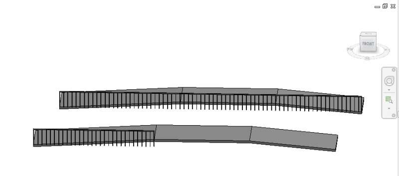

How can i create a railing in the flooring which is modified using sub elemets like in the attached picture
While in sketch mode use the Split Element tool to "segment" the path. Select each segment, and on the Modify Bar, you can adjust each segment individually. The middle segment should be set to "flat" while the others to sloped.
