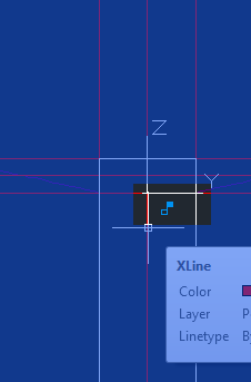

Hi!
I can't find explanation for the small icon. The icon is in the dark area of the enclosed picture. What is the name and meaning of this icon?
Thank you for the help.
You have some objects with constraints applied. If you don't need them you can use the delconstraint command, also turn off Infer at the very bottom almost all the way to the left.
Thank you rkent for the key word "constraint". I found with it this explanation:
"A small blue glyph displays with your cursor when you move it over a constrained object."
