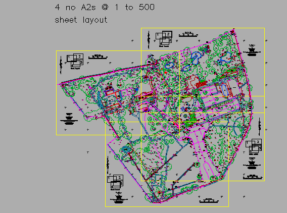

Something like this picture. The viewports are coloured yellow and are non-printing
Is that made with RobDraw method?
If RobDraw invented it 20 years ago, then yes it is. Otherwise it is the method that I have been using for 20 or more years.
Unusually, I print drawings with no formal title block. I use the fullest expanse of the paper, because surveys come in all shapes and sizes.
I have blocks of all the sheets sizes drawn at 1 to 1, and then insert them into a drawing at the required scale. By copying this block around the drawing, you can organize the sheet layout. (put the blocks on a layer Viewport and make it non plotting).
In paper space, I manually get the required shape to nearly fill the screen, then pick the viewport and set it to the required scale. Then you can pan the drawing until it matches the viewport, and then lock the viewport. Continue with all sheets.
In model space, the layout of the viewports can be copied and scaled down to give a sheet layout for each sheet. Manually increase the width for that particular sheet.
