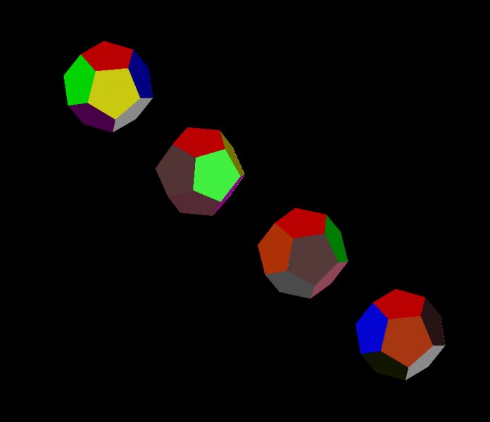

I think I may have found an easy way to construct a dodecahedron.
Edited by ReMark
Four views of my dodecahedron. Each face is a single region that I created (on layer "0") then changed its color.

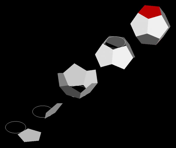

I created a five sided polygon on layer "0". I then turned it into a region using the REGION command. Since it was created on layer "0" I can override the layer color and make it any color I want. That is how I got my twelve colors.
I'll provide you with an image in just a moment of the steps I took. Hold on. I'll be back.8)
Does this make it any clearer?
The first polygon was rotated 63.43 degrees then I did a polar array. After that it was merely copy, rotate, move and add the top and bottom faces. Done.
