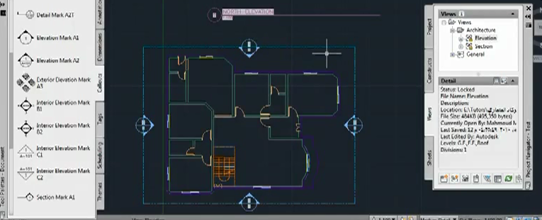

hamidciv Posted August 21, 2014 Author Posted August 21, 2014 (edited) dear remark this is 2d plan the in learning video by ahmad qahtan is shown in youtube under title elevation§ion, I was surprised when I saw this video , i send link for you, please explain for me , how do this? thanks a lot Edited August 21, 2014 by hamidciv Quote

hamidciv Posted August 21, 2014 Author Posted August 21, 2014 mr qahtan using autocad do this, i attached image at work. I know you can do it by REVIT SOFTWARE , but whether it is possible with AutoCAD??????? THANKS Quote

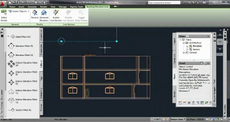

hamidciv Posted August 21, 2014 Author Posted August 21, 2014 DEAR REMARK in this video only used 2d plan, and with useing 2d plan, elevation& section Is plotted. this photo elevation with using this method is shown thanks Quote

danellis Posted August 21, 2014 Posted August 21, 2014 That screen grab is from an AutoCAD derivative, or vertical to use the more common term, called AutoCAD Architecture. Although that view is a 2D plan view, it works by placing 3D walls, windows, doors and so on into position, and telling those walls, etc., how wide and tall they are, what they're made of for hatching on elevations and sections, all in 3D. dJE Quote
