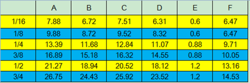

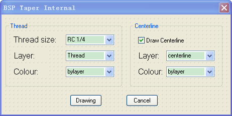

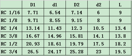

AIberto Posted August 26, 2014 Posted August 26, 2014 (edited) Hi Dear friend: Have time to help me? I appriciate your help! My frist topic in Cadtutor http://www.cadtutor.net/forum/showthread.php?86230-How-to-drawing-Taper-Pipe-Threads I want use lisp to draw that. Drawing BSP Taper Internal thread Like this: [ATTACH]50559[/ATTACH] I want Pick up two point, draw thread. Note: Two Point (PT1&PT2) not on a horizontal or vertical line. Maybe on a tilted line, like this: [ATTACH]50555[/ATTACH] Cadtutor.com has asimilar Topic: http://www.cadtutor.net/forum/showthread.php?86379-Draw-countersink Thread size & parameter. [ATTACH]50558[/ATTACH] I think need a dialog like this: I hope all options in dialog can memory. Edited September 3, 2014 by AIberto Quote
Tharwat Posted August 26, 2014 Posted August 26, 2014 I think the Dynamic Block should be able to make them in one Block with the options fore-said above , I did not try but you can start with . Quote

Tharwat Posted August 28, 2014 Posted August 28, 2014 OK! No problem. I don't understand programming, I'm just the draftsman . Do you have any more Thread Styles than these you included the above green table ? If yse , just post them here to allow me to include them in the program . Haha. It's also a solution. I don't like sarcastic manner that holds no respects . Quote

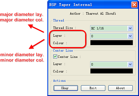

AIberto Posted August 28, 2014 Author Posted August 28, 2014 Try it and let me know . Thanks,Tharwat. It's nice ! There is a little defective 1.The extensions of the center lines are static with the current value (1.34) This is not what I want . I want : 0.1*(The length between PT1 to PT2) . 2.The centerline of the linear scale set to 0.5 Quote
Tharwat Posted August 28, 2014 Posted August 28, 2014 1.The extensions of the center lines are static with the current value (1.34) This is not what I want . I want : 0.1*(The length between PT1 to PT2) I am sorry , I considered the length of the Taper , so I have to change it as you want . no problem . 2.The centerline of the linear scale set to 0.5 Not clear enough . explain it more . Quote
AIberto Posted August 28, 2014 Author Posted August 28, 2014 Not clear enough . explain it more . sorry.I mean the linetype scale set to 0.5 (centerline) Quote
Tharwat Posted August 28, 2014 Posted August 28, 2014 Try this modified program now and let me know . BSP.rar Quote
AIberto Posted August 28, 2014 Author Posted August 28, 2014 Try this modified program now and let me know . OK! very nice! There is no problem! Big big big big big thanks! Quote
