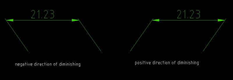

77077 Posted August 26, 2014 Posted August 26, 2014 dimaligned & dimlinear oblique. can multi-select . use " use ">" key to positive direction of diminishing , once "5" degree. eg: 85 , 80, 75.... still 15 . Quote

Tharwat Posted August 27, 2014 Posted August 27, 2014 How could you modify the dimension to be in that shape ? I mean what are the properties to change ? Quote
77077 Posted August 27, 2014 Author Posted August 27, 2014 How could you modify the dimension to be in that shape ?I mean what are the properties to change ? COMMAND: _dimedit----> O OR Menu----> Dimension----> Oblique Quote

77077 Posted August 27, 2014 Author Posted August 27, 2014 Try this . Thanks ! Can use keyboard do adjusted value ? use " use ">" key to positive direction of diminishing , once "5" degree. eg: 85 , 80, 75.... still 15 . Quote
77077 Posted August 27, 2014 Author Posted August 27, 2014 I did not get your request enough . You are enthusiastic. help me modify again. Many thanks. Quote
Tharwat Posted August 27, 2014 Posted August 27, 2014 I mean I did understand your last request , so explain it in more details to allow me to modify the routine . Quote
77077 Posted August 28, 2014 Author Posted August 28, 2014 I mean I did understand your last request , so explain it in more details to allow me to modify the routine . Understand this? use "A" key to negative direction of diminishing , once "5" degree. eg: -85 , -80 ,-75,......still -15 use "S" key to positive direction of diminishing , once "5" degree. eg: 85 , 80, 75.... still 15 . It means: Press the "A" key on the keyboard .Pressed once, Oblique value=-85, Pressed once again,Oblique value=-80..........The minimum value =-15 Press the "S" key on the keyboard .Pressed once, Oblique value=85, Pressed once again,Oblique value=80..........The minimum value =15 Quote
