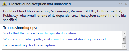

here is the error I get now:
I have double checked and the files are actually where they are supposed to be.
That is the same code you posted above, and equally ambiguous.
It is impossible to assist you with where your code is broken, if we cannot see the code. So unless just asking a general question and expecting nothing but at best entertaining opinions in response, kindly be less ambiguous.

I do think I see where I am confused. I was trying to run this code as a simple windows form and not a class library from within autocad using the netload command.
I recognize that you're not seeing it; that's why I'm trying to help point you in the right direction, which obviously requires sufficient information (else wastes both our time).
I also thank you for finally clarifying what you're trying to do (Windows Form Application).
What you've unknowingly overlooked, is that the ObjectARX SDK provides _both_ .NET and COM assemblies... The former are located in ..\inc\ directory, whereas the latter are located in either ..\inc-x64\ or ..\inc-win32\ directories as COM is environment dependent (.NET works in both 32-bit & 64-bit environments, hence 'AnyCPU', etc.).
You can successfully use COM in, and outside of AutoCAD, but identifying that leads to different recommendations as to a potential resolution to the behavior you're observing.

That is COM code, and not .NET as only COM utilizes the Interop assembly references... This code also needs to be compiled to 64-bit assembly, since you're working in Win7x64 according to your description above.
Nearly all of my AutoCAD development is for plug-ins, and what little COM I used to implement, has since been ported over to .NET with the advent of the dynamic keyword, and P/Invoke.
Now, you can still do what you're after using your Forms app, but it's going to be somewhat slower, and certainly a bit more complex than simply doing so from within an instance of AutoCAD. Please see this post for more information on how to accomplish what you're after using .NET API. For more information on Autoloader, please see the link in my signature.
