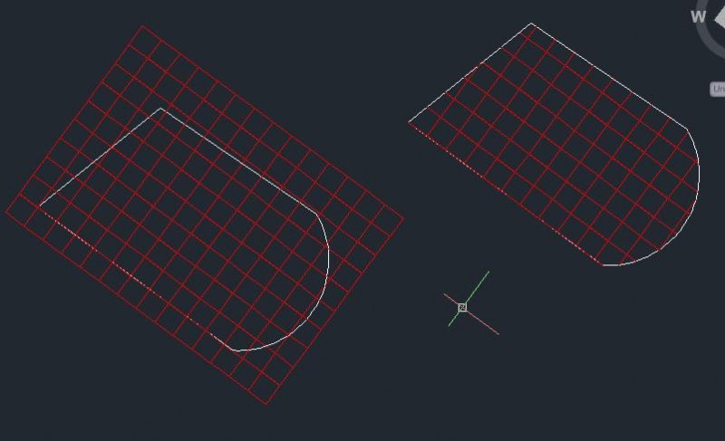

I need a lisp can calculate area and perimeter. That lisp isn't hard to be found.
But I need one more thing. Insert floor (0.5x0.5) in it. Hatch could be a good way to do that.
I'd like to know How many floors was used and hatch can't be counted, right?
Can anyone help me out, please?

There are some ways of using Array to make a pattern of say floor tiles then trim to a pline boundary you can then count up tiles, try Array and Extrim. Your dwg is exactly what I am talking about its the one bit of code I no longer have. I have been meaning to rewrite it again.
Looking again. UCS OB this sets the angle for use with Array of your plines make larger than shape use extrim and Cookiecutter.lsp, use Filter select plines gives total, Ucs W all done.

I'm drawing a square 0.50x0.50, put it the point origin and use copy/array command and extrim command.
All my task is using autocad command and It is good by the way.
But I'd like to make it easier, maybe a lisp can help me out.
So, My task (file dwg) is attached. If someone is interested, I'll be really glad!
Thank in advance
The lisp I wrote did just that pick pline near corner splat all done unfortunately I do not have it. Just a time thing to redo. Get priorities right going fishing.

I have just wrote this piece of codes to draw boxed in the area that you would specify on screen , try it and let me know .

Thank you Tharwat!!!
The code worked perfect.
I need to set the origin (when the box starts) .
But when was a perimeter with irregular form, I couldn't inserted the box all my figure.
To rectangle or square worked perfect!
Thank you very
I'm really happy with the goal :D
Happy that you liked the codes :)
The routine creates boxes in a rectangle shape ONLY .
What do you mean to set the origin with box starts ?

For the irregular forms , it won't work with them and that's why I forced the user to pick two opposite points that shape a rectangle .
But for the origin , that is something will become complicated and over my head now . :( and I may try to work on it later on .

Tharwat as I said earlier its pretty easy yes you need to pick a start corner to line up the objects from, the way I did it was to isolate the pline object put on temp layer then simply window the pline this sets the bounding area to fill which is bigger than the any shape pline including curves. Next is to use the offset to the pline to trim the boxes that need to be cut, then do some layer stuff and all done, I am sure I used a multiple offset method to erase the trimmed objects on the outside. Its about the only bit of code I dont have.
