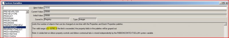

How can i increase text selection?
AutoCad 2014
Thanks
Do you mean that you need to select more than 32767 Text entities? Afraid you are out of luck, if you need them to display PROPERTIES while selected, that is the maximum value. I believe that Select Similar may not have such a limit, so perhaps you could give that a try instead.
