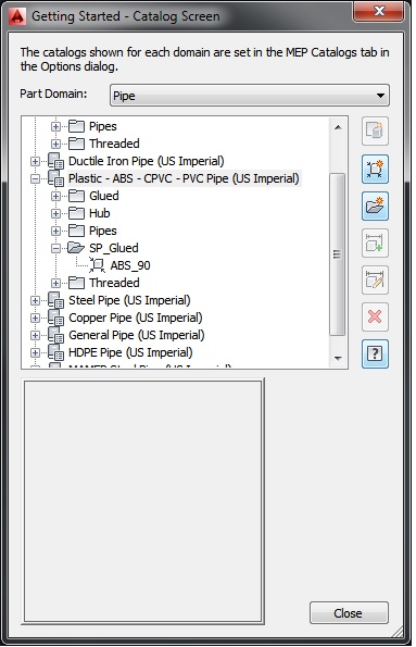

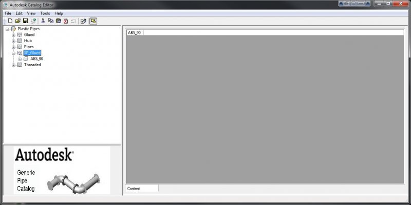

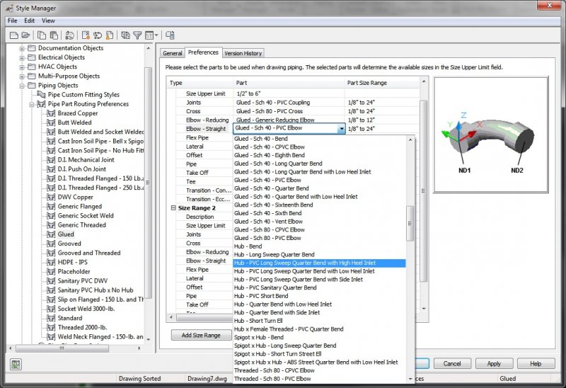

Well that is a bit misleading. It works in the drawing, but I can't seem to find the fitting in styles manager. I made a new chapter named SP_Glued under the pipe>plastic-ABS-CPVC-PVC Pipe (US Imperial) folder in the catalog. In that folder i made a new fitting named ABS_90. It shows up in the content creator, and the catalog editor. But when I go into the style editor screen. I go to the Piping Objects>Pipe Part Routing Preferences> Glued When I try to select Elbow - Straight or reducing, my fitting doesn't show up in the list. If I go into the drawing and insert a plumbing fitting it works fine though. I attached some pics.

Did you regen the catalog? I believe the command is CATALOGREGEN - going off memory though. Just choose "all" when it prompts you.
