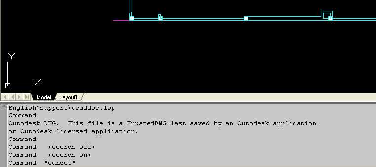

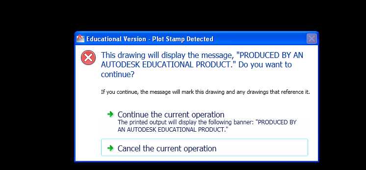

vnanhvu Posted September 4, 2014 Author Posted September 4, 2014 I opened the drawing and wblock the entire drawing without any error and it did work normally . I open and: ..... -Pic name: Error ( when i open first ) I click: " Continue the current operation " -Error 2: When i click " Continue " -Error 3: When i click " Show Proxy Graphics " -Error 4: Display in : Command line Quote

Tharwat Posted September 4, 2014 Posted September 4, 2014 The first post is different than the last one in post # 11 Go to options and in the TAB ( open and save ) to the right bottom and you should see a check post for "Show proxy information ...... so un-check the box to avoid the display of the dialog box . Quote
