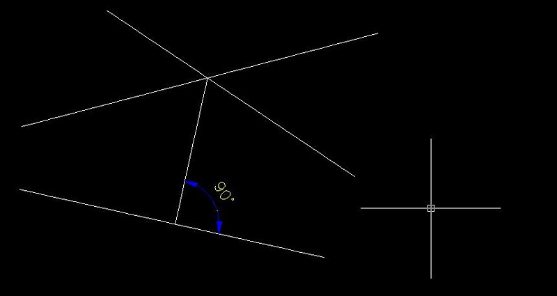

I have three polylines. Two of these intersect and make something like an X. My third polyline does not intersect with these two. Now, I want to create a perpendicular line start point being the intersection point of these two lines.

Command: line
Specify first point: int
of (select intersection)
Specify next point or [undo]: per
to (select third line)
I'm assuming you mean perpendicular to the third line that does not intersect the other two - like attached?
Do you really need a LISP to accomplish this - is it not just easier to draw the line yourself, as I have done in the example?
lpseifert has shown you how in his above post...
