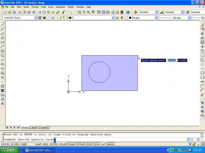

Can someone here tell me where to find the toggle switch to turn off the feature that adds a shaded rectangle and windows holding dimensions in Autocad version 2007? I enclose an image of what I am referring to.
Thank you,
Ahmad Davidoff
Options > Selection Tab > Visual Effect Settings. Or type SELECTIONAREAOPACITY and set it to 0 (zero).
Steven is right. I didn't read thoroughly enough on the original poster's inquiry.
