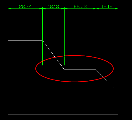

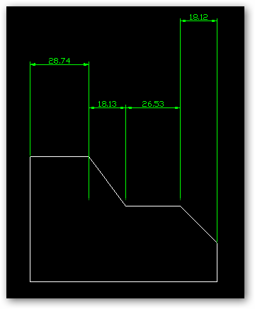

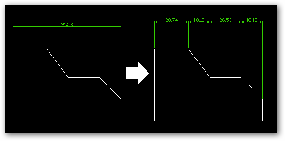

This is the effect of need :
But, the reality is like this:
Would also like this :
Hi guys! I need some help !

I did not run code but maybe a different approach taking two versions HOR & VER, Pick stpt next next next next endpt then pick a point for the adjusted level of the intermediate dims and final top level. So you have a pt list you know 1st and last then run dim command just using a loop for start and end pts. This way draw dims as you go rather than adjust.

You change this paragraph:
OK! Thank you sir.
But,dimension becomes high and low.
It depends on your dimstyle setting. Can you upload your file with dimstyles?
Dear sir
Thanks , The dimstyles is default . I use New document.
test.dwg
You have to change also this paragraph:

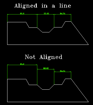

here is another, Dimension merge, multiple merged into one .
But need dimension aligned ia a line, Otherwise,can't merge.
As shown in the image below .
The first case can merge.
The second case can't merge,because the dimension not aligned.
need if not aligned, still can merge.

Use the command: dimcontinue
Dear Tharwat. thank you! I know "dimcontinue" ;)
You delete 2 lines of your code, it will work.
