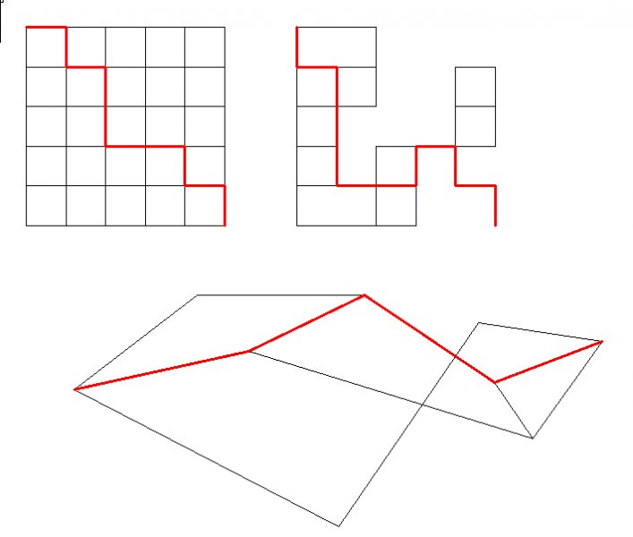

Hello,
for a project I needed to find the shortest way between two points in a network, so I searched for a pathfinding algorithm in AutoLISP. Since I did not find anything - here comes my implementation of the A* pathfinding algorithm. (If you don't know what A* is - I got my information here: http://en.wikipedia.org/wiki/A*_search_algorithm)
The program finds the shortest way in a network of polylines between two points, the polylines representing the paths you are allowed to move along. Two polylines are considered connected if one of their vertices match. The resulting path is returned as a new polyline.
The program and a test.dwg are attached to this post.
I would like to extent the network/edges in a way, that polylines are also considered connected if the vertice of one of them is on the line of another. I could use some help with that.
I hope this is useful for someone.

Here I've revised Helmut's code and made it faster.
;; Pathfinding with the A* algorithm      by ymg 22/07/2024                   ;
;; Revised a prog by  HELMUT SCHRÖDER - heschr@gmx.de - 2014-09-14            ;
;; found at Cadtutor.net                                                      ;
;; Kept the same format for edges list but added lines as valid choice        ;
;; Format: (((x1 y1) (x2 y2)) (((x2 y2) (x3 y3))....(xn yn)))                 ;
;; The user is asked to pick a start and an endpoint.                         ;
;; The program will find the shortest path in a network of connected          ;
;; polylines and/or lines and draw a new polyline representing the result.    ;
;; Two lists of nodes openlst and closelst are created from the above         ;
;; mentionned edges list. The format of a node list is:                       ;
;;  (((Point) (Prev Point) Cumulated_Distance Estimated_Total_Distance)...)   ;
;; Main change from origina are:                                              ;
;;   - cons the list instead of append                                        ;
;;   - vl-sort the openlist instead of the quicksort                          ;
;;   - Replaced and renamed some vars and subroutine.                         ;
;;   - Added fuzz 1e-4 to all points comparison                               ;
;;   - Change the get_path function                                           ;
;;   - Added line as possible edges                                           ;
;;   - Added an error handler                                                 ;
;;   - Added a timer to the search portion of the program                     ;
;; The above changes amounted to an acceleration of about 4x from the         ;
;; original program.                                                          ;
;; If you compile this program to a .fas you'll get more than 10x faster.     ;

I think this is an extremely interesting problem that deserves significantly more lines of code than have been written so far in this thread.
I believe those lines shouldn't be long in coming.
  • Like 2
On 5/12/2019 at 2:31 AM, Shady_Potato said:
This is Amazing work!, but what if there were multiple Objectives? Could there be a way to create a multi-objective pathfinder? For example In HVAC; Say If the Staring point is Given, But I want to Route my ducts to multiple Registers, Is there a way A* could do that?
I know this query is old, but...
Maybe for the path to multiple locations use the Traveling Salesman Problem (TSP) algorithm. @marko_ribar has a LISP on CADTutor.
Bellman-Ford algorithm can handle the shortest path from a single source to all other nodes might work.

Never tried the dict trick to accelerate the retrieval but it seems a good idea.  However as of your last edited code the path found is erroneous.  See the attached image.
It's difficult to know what's happening there without the original drawing and without knowing the starting and ending points.
I reproduced that drawing from your image and ran the code without any problems.
But perhaps I'm wrong.
PS: Anyway, try your code on this drawing (mine will return the same result because it only speeds up the process).
YMG3.dwg
I've left a yellow line on a different layer from the rest so that it's outside the selection set, and the start and end points are marked with little circles.
  • Agree 1
The original drawing is attached with my post as AStar Test.dwg.  Start point is upper left.
ymg
astar test.dwg
Also you must realize that if two polylines crosses the intersection point is not necessarily a node.
ymg
Edited by ymg3
I thought it was a given that all intersections necessarily divide the polylines.
I must admit I didn't see your drawing until now.
I apologize for that.
I've attached modified code to fix this.
Added or modified code by GLAVCVS (january 2026)
	-All set are grouped into one
	-An associative sparse matrix cell->handles is created for faster cell querying (using new 'addToDict' and 'getCell' functions)
	-The "edges" list is replaced with the local search retourned by 'getCell'
 T E S T S =====
 	fas:  4-5 x faster than previous fas

👍Looks OK to me, and a nice acceleration.
ymg
Edited by ymg3
Hi...
I've seen @GLAVCVS code and found that it had some lacks... I've debugged it and make it work for lines and path in 3d... Path is now 3D POLYLINE and selection of network edges are lines in 3D... I've shortened complete code and left only necessary subs and comments... So, this is my revision and I hope it could also be beneficial...

I was thinking of a scenario like the one shown in the drawings attached so far.
But are you sure the modifications you’re suggesting are really necessary?
If you attach a drawing showing the situation you’re referring to, I’ll understand it better.
In any case, considering 3D linear objects has some interesting implications, because it introduces an additional variable into the cost (the elevation difference) …
What if we want to add more variables to the cost of each segment?
Encoding them through some property like color, thickness, etc.?
And replacing the function "distance" as the central cost estimator with another one ("valuate", for example) that also weighs additional variables?
I'll attach *.DWG on which I tested path finding... Network was generated from Polygon Mesh... Mesh was exploded into 3DFACE entities and then those 3DFACEs extracted LINEs in 3D... Along with *.DWG, I'll post short *.lsp for extracting LINEs from 3DFACEs...

I think I understand the problem now.
But it only happens with lines. With polylines, whether 3D or not, this doesn't happen.
The issue is that "getPointAtParam" doesn't work the same way with lines as it does with polylines.
If param=1, it doesn't return the expected result.
I've modified the code to fix this (I think)

Added or revised code by GLAVCVS (january 2026)
 T E S T S =====
 	lsp:  7-8 x faster than previous lsp
