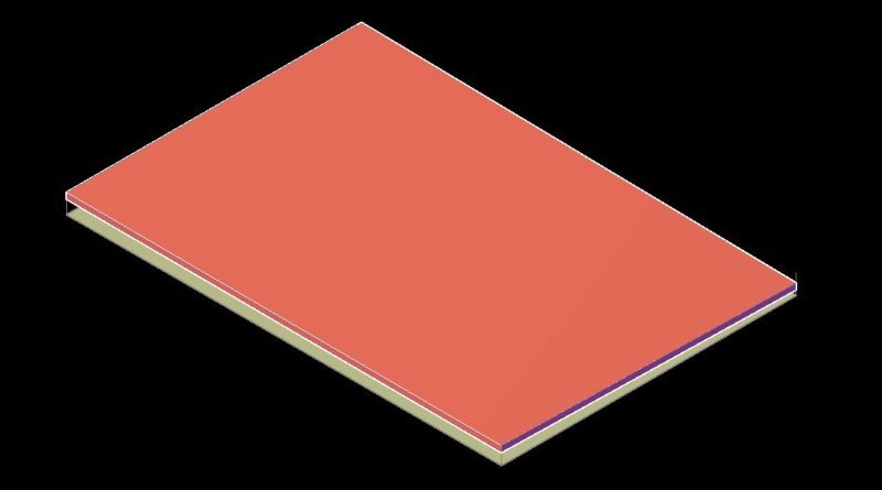

MikeMc52 Posted September 12, 2014 Posted September 12, 2014 Hi, I have attached a drawing show a surface that is in one plane. Above the plane is the actual outline of the area I woul like to create a 6" solid to represent concrete paving. I can't figure out how to make a solid 6" thick for this drawing. See attached. Thanks, MichaelStripper Area Paving.dwg Quote
ReMark Posted September 12, 2014 Posted September 12, 2014 Loft two lines to create a surface then use the THICKEN command to convert to a solid of the appropriate height. Not 100% sure if this is what you are looking for. Quote
MikeMc52 Posted September 12, 2014 Author Posted September 12, 2014 Thanks ReMark!! I was sure it was pretty easy but just could not figure out how to get there. Michael Quote
MikeMc52 Posted September 12, 2014 Author Posted September 12, 2014 Oh yes. I actually had to draw two rectangles and loft them, because using the thicking command on the surface cause the edges to "stick out". Thanks again. Quote
ReMark Posted September 12, 2014 Posted September 12, 2014 Can we see an image of the final solution? Quote
MikeMc52 Posted September 12, 2014 Author Posted September 12, 2014 Remark, Attachedis the kinda finished slab. There is a lot more to do the drawing before I can submitit for review. There will be a flash tower and two strippers on the key shapedpad and a pump on each of the rectangular pads. There is a drain pipe (sloped)that will empty into the pit, which I have not located yet Stripper Area Sump Layout A.dwg Stripper Area Paving.dwg Quote

magmor99 Posted October 14, 2014 Posted October 14, 2014 I would draw the shape and extrude it to the depth required. I haven't ever used loft, would it produce the same end result? Quote
JD Mather Posted October 14, 2014 Posted October 14, 2014 I would draw the shape and extrude it to the depth required. I haven't ever used loft, would it produce the same end result? How would you get non-planar faces using an Extrude technique? Quote
magmor99 Posted October 14, 2014 Posted October 14, 2014 Hi JD, The original post "I have attached a drawing show a surface that is in one plane. Above the plane is the actual outline of the area I would like to create a 6" solid to represent concrete paving. I can't figure out how to make a solid 6" thick for this drawing. See attached." I would draw my rectangular polyline ,the size required, and use the extrude command to create a depth of 6". Am I missing something? I am assuming the placement of the concrete paving in the vertical plane is known? I'm fairly new to 3d, so if there is a better/more efficient way, I'd welcome the information. Quote
magmor99 Posted October 14, 2014 Posted October 14, 2014 JD, So sorry, I just opened the OP's drawing, and realized that the pavement is sloped. Please disregard my earlier post. Quote
JD Mather Posted October 14, 2014 Posted October 14, 2014 JD,So sorry, I just opened the OP's drawing, and realized that the pavement is sloped. Please disregard my earlier post. Note also the original title of the thread. The warp or twisting in this one is not very great, so it is easy to mistake it for a planar extrusion. Quote
