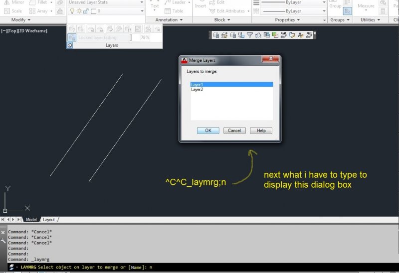

Dear all;
How to write a Macro for Merge Layers..............
^C^C_laymrg;n; next
thanks
Romano

Thanks steven for your response
i don't want this way, i can't type the layer names their
I would like to know is there any way for this
Regards
Romano

sorry, the last image should come first.........
I need some can fast merge layers (this happens, when more people works with same cad file)

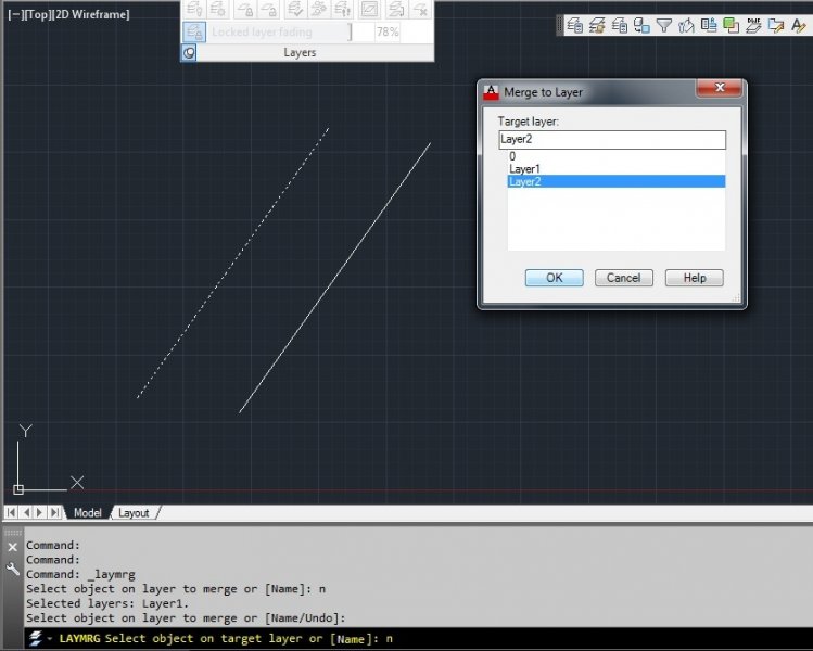

You cannot get a macro to work with dialogue boxes, thats one of the limitations of using a macro. So you either need to supply the names in the macro, or run the command from a toolbar/command line.

I might not understand exactly what you want, but if you know all the possible asphalt layer names, you can write a macro that will combine them all into 1. The hyphen "-" before the command "-LAYMRG" will stop any dialog box from appearing. To me that is the best way to the macro to help you save time.
This one puts the first 5 from your list all into layer 6:
^C^C-LAYMRG;Name;"Asphalt Edge";Name;ASPHALTEDGE;Name;"ROAD ASPHALT EDGE";Name;"ROAD EDGE";Name;ROAD_EDGE;;Name;ASPHALT-ROAD;Yes;
To be safer you might need to create the destination layer at the beginning of the macro. Something like:
-LAYER;NEW;ASPHALT-ROAD;;
